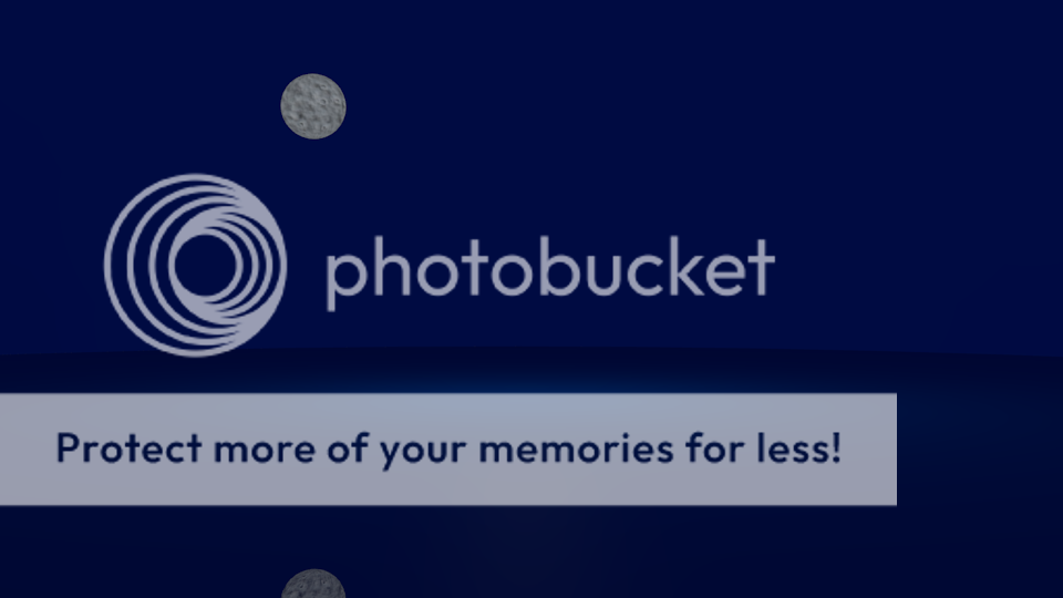

How do I make a plane ripple and move around like water? I don't mean fluid simulations or anything that will make render time very slow, I mean a cheap trick that makes it look like water.
The water (the plane) is not interacted with and is just something that a character looks out at.
This is what I currently have for the visuals. (not including land or objects)
-plane (for water)
-two mesh spheres (sky and moon)

paulo_gomes wrote:take a look at this:
http://www.yofrankie.org/tutorial-animated-normal-maps/
Thanks, that worked out well!
http://www.youtube.com/watch?v=cmzoQcj7Kmk
now if I could figure out how to add stars everywhere. lol Is there a way to add them? Ones that will reflect in the water i mean.
