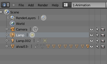

The rendering view shows a sort of lime green background and the tank appears with lighting highlights from the two light sources. The camera point of view I see during rendering matches what I was seeing while creating the key frames. Looking at different information (see image)
. . . . I think I only have one camera active (right?)

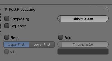

With reference to the sequencer being turned on (or off), I think it is turned off, see the screen shot.

simtron wrote:Possible reasons:
1>You may have no light in the scene.
2>You might have another camera which is active for rendering but facing some where else.
3>You might have turned on the sequencer in the post processing panel of render menu.
You told that you can see the tank moving and turret pivoting.Is it in the 3d view or in the actively rendered frame??Coz if it is in active rendered frame,1,2 may not apply.
Also check output format just in case.
