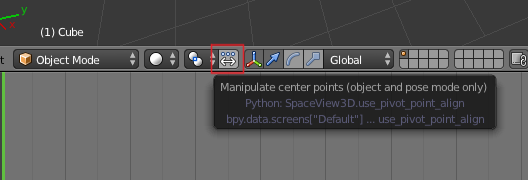

Hey. I just found your topic and saw you have the same problem as me. Acidently I found a solution.
In my case was this button causing problem, maybe is the same.
