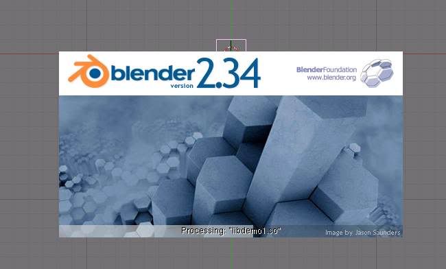

Well, now that I have handed in and looking for a job I have had some time left over for debugging module-core.c, and in doing so have had to create some extra modules:
The reason why I gan give you this screenshot is because somewhere is an infinite loop causing the bootup sequence to freeze...
The next release will have basically the message passing subsystem working as well as some more of the APIs (memory, DLL loading and the APIs assioacated with module instanting). And, maybe after that some kind of a module build system (based on scons of course) however that is for the future.
