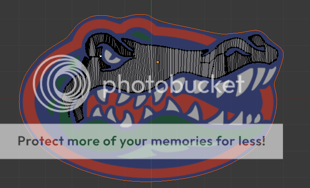

2. I am starting my first box modeling project (ever) and its a big one. I was just wondering how I would go about box modeling the rest of the image (below) and making sure each color is a different object all together? After that, when I extrude it (after its all box modeled) will the teeth automatically be 3d or will I have to add extra effects to it?
